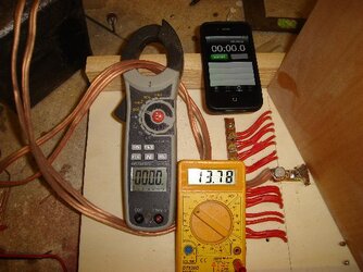

so mal die bilder
[attachment=5:1i7ztpoi]image036.jpg[/attachment:1i7ztpoi][attachment=6:1i7ztpoi]image003.jpg[/attachment:1i7ztpoi]
[attachment=4:1i7ztpoi]image001.jpg[/attachment:1i7ztpoi][attachment=3:1i7ztpoi]image020.jpg[/attachment:1i7ztpoi]
[attachment=2:1i7ztpoi]image030.jpg[/attachment:1i7ztpoi][attachment=1:1i7ztpoi]image037.jpg[/attachment:1i7ztpoi]
[attachment=0:1i7ztpoi]image038.jpg[/attachment:1i7ztpoi]
